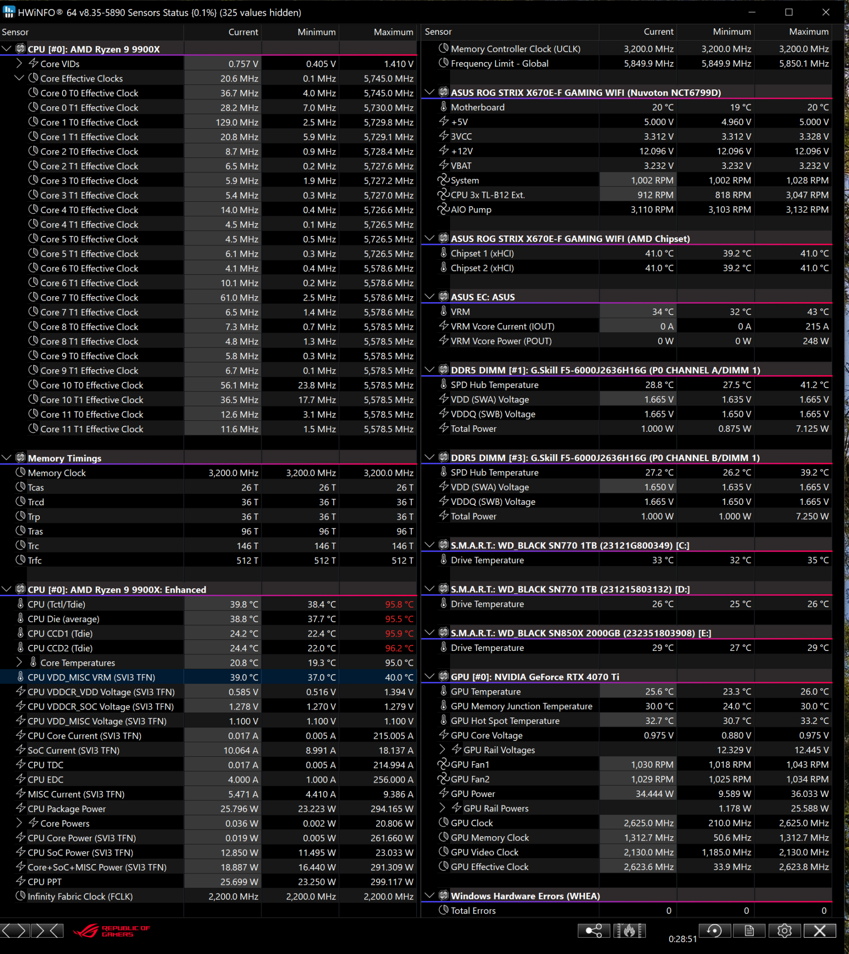

I've got my 9800X3D dialed in at 5425MHz and 1.23V. I'm not 100% certain on the max safe limit, yet my 9950X3D and 9800X3D would hit 1.39 to 1.4V at stock.
I was just playing with OCCT a little bit, but you can see she wanted to go. If I had my CPU fans running at full speed to grab the chill in the air then it would have.
Also, I meant to say 1.415 teehee.. still got a lil bit to go..
The problem is not the safe voltages, but that in manual mode OC Ryzen stops maintaining temperature.
So yes, we can set the 9800x3D to manual mode at 5600 MHz, but we have to very carefully manage what software we are going to run, because if we run something very heavy, it will shut down immediately.
Normally PBO manages the CPU frequency, but manual OC will just run it at 5600 MHz.
So yeah, somehow we can play games with manual OC and it's really better because we gain some ns that normally PBO uses to manage the frequency and that's a plus for gaming, but we can't control the temperature and that's a risk of CPU overheating.
Here's a clear picture regarding that, here the processor is only at 5250MHz but in manual OC, and you can see that it easily hit 98C (194w).
Because that's why I asked how this "5.6GHz" is achieved, because with an expensive motherboard that has a clock generator that can increase the FCLK of just the CPU, then the PBO can reach a really high frequency where it will also maintain its temperature.
So AMD are playing a bit of a tricky game here with this and just selling some "frequency numbers" because they control it via AGESA. Of course, they combine this with good binned chips.
