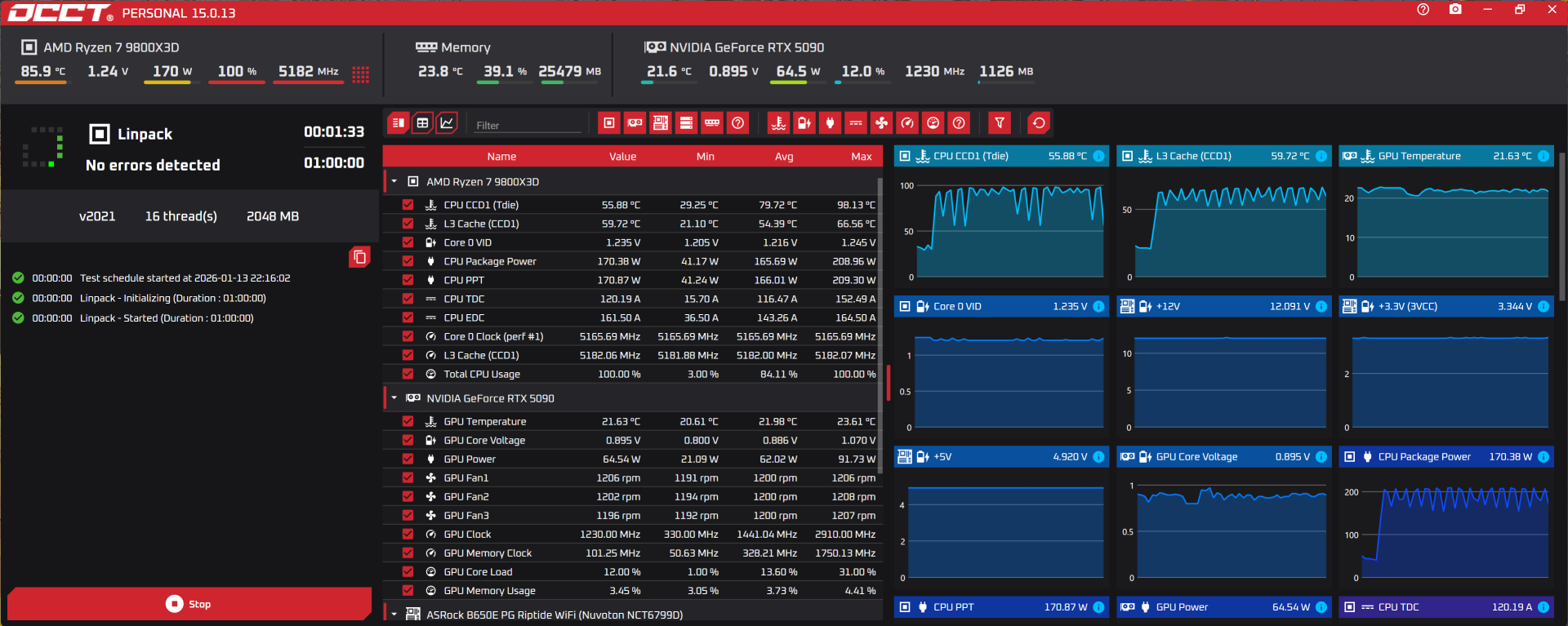

Here is OCCT>Linpack 2021, manual 5175MHz@Auto voltage, level 2 LLC and water 14-15 °C temp = 165-208w and 79-98 °C.
I started at 5275MHz, but it just froze, probably because there are too high temperature amplitudes or not enough voltage.

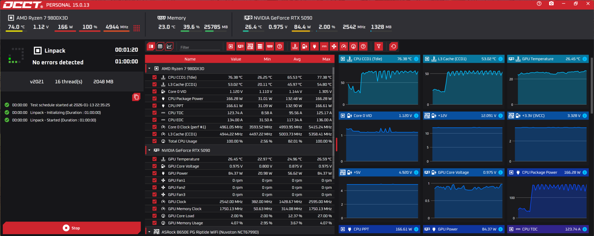

Here is PBO+200 (5450 MHz) Negative -19, LLC 3 (lowest), -5 voltage offset, water temperature 15 °C.
So the frequency jumps from 4950 to 5100 MHz, which means 100-150MHz lower, 15-20 °C lower temperature and 30-40 watts lower consumption, yeah PBO work...
