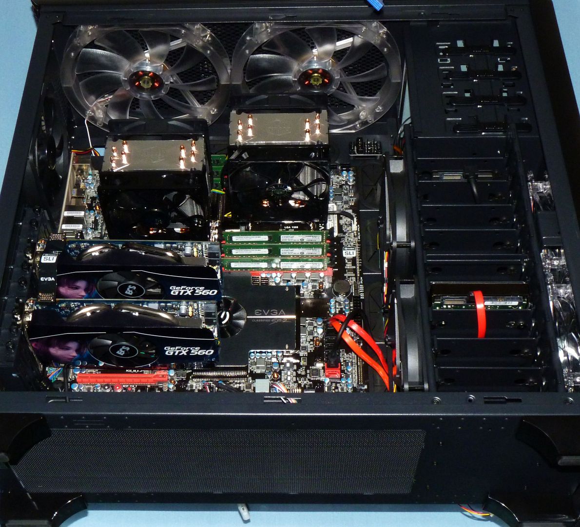

Build is with 24 Gb RAM (Crucial 6 x 4Gb1600), 128 Gb SSD also by Crucial, I'm told it will run with the big dogs, with a firmware update 0009. (?), not sure what that means yet. I Tb HDD, soon to be joined by more for a RAID config.
Two 212 EVO coolers with four 120mm Blademasters, all other fans, 5 x 140mm plus a 120 on the side under the CPUs, are on a NZXT controller, except the big side fan.

Click on the small photo to see the large & larger one, if your browser does such things.
