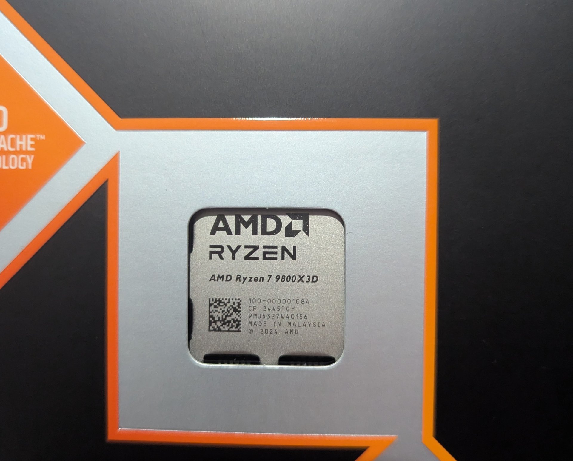

Had one backordered on Amazon but Newegg just popped. Should get it by Dec 10th. Used free tier HotStock app for alert.
Easy peasy.
Nice. Where did you get it from? Still waiting on my Amazon order from November 12 to ship.
