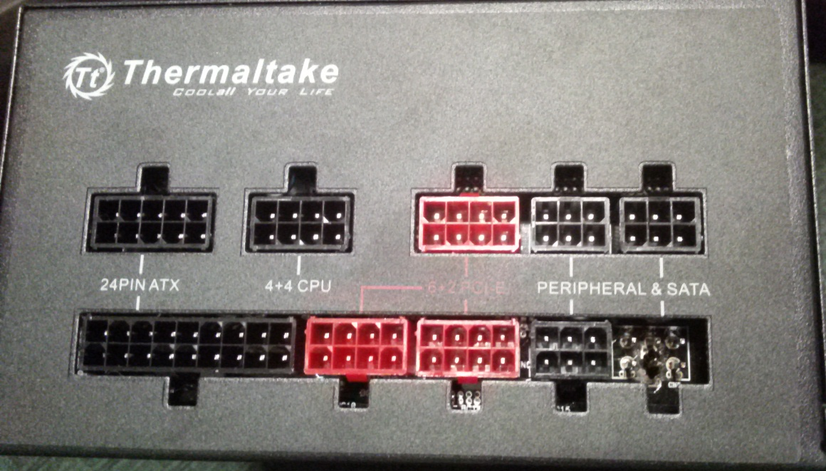

I think several people in this thread may be missing the point.
It is neither the SATA or MOLEX connector that is a problem,
and in the case my two fires, wasn't wire gauge either.
Its that whenever SATA or MOLEX are involved, 12V necks
down to ONE PIN at the supply. And the modular connector
there is usually what burns up before anything else.
This was a pair of 1050ti's on one SATA peripheral string.
I guesstimate damage was caused by about 13A.
Every piddly negligible load adds up, and those strings will
let you plug in as many as four. Not that you ever should...
Supply still works, but 10yr warranty is probably void.
