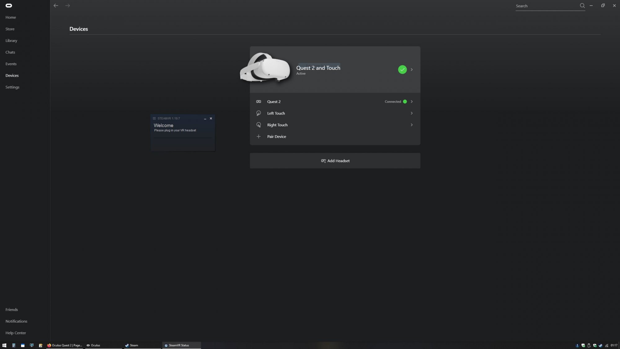

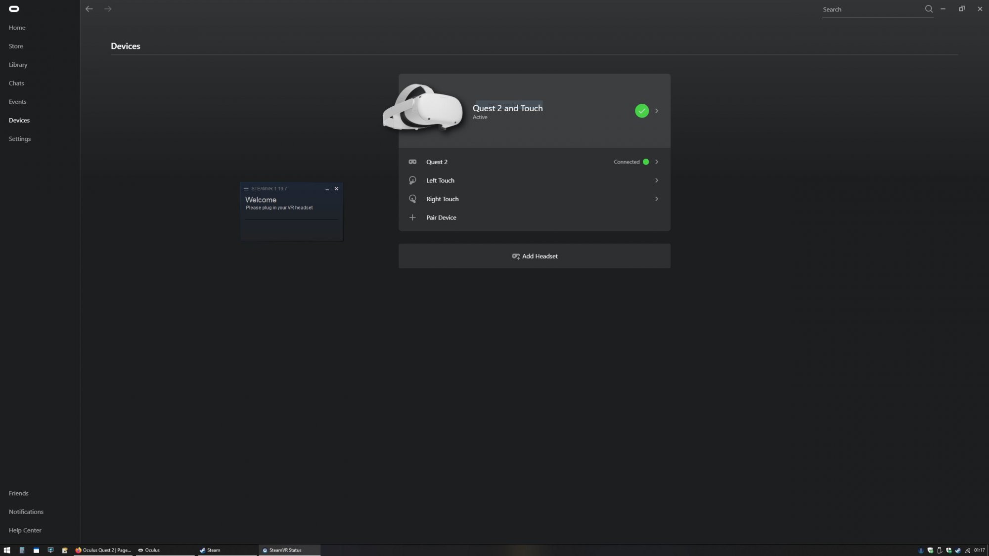

I downloaded SteamVR and have Subnautica in my games list on Steam. When I connect the Quest 2 via the Link cable to my PC, SteamVR just says "please plug in your VR headset" and nothing else happens =/ (The Oculus program is installed and configured already and shows the Quest 2 as green and connected/active in the GUI).
If I still go ahead and launch Subnautica in VR mode, all I get is sound going to the Quest, but no game displays or anything
Did you keep the Oculus app running before firing up SteamVR? It needs to be constantly opened while in VR nowadays.

The Oculus app is running, still the same =/ and I don't know how to launch a game from within the Quest, when I go into the Oculus Link thing in the Quest dashboard on the headset, no games show up or anything (I guess because it can't interface with Steam via SteamVR in the first place)
You have to choose desktop from the overlay menu and then just use the controllers to control your PC and launch it from there.

Are you using Link or Air Link? Even if the device show up, I remember you still need to "pair" them. When you connect the USB C cable, don't allow storage access in the Q2. That'll then prompt you to pair Link IIRC.
This is how it should go, you open Oculus Rift software first.
Then you put on Oculus Quest and turn on the Link (it should ask you about this unless you have clicked "never show again"). Then it kicks you out if the Quest and you should see the Rift's home screen/dash board. This is the dashboard every old Oculus Rift / Rift S users see.
Then you can take the headset off and turn on SteamVR from Steam. Then put the headset back on. After few seconds it should kick you out of the Rift dashboard and you should see Steam's dashboard.
After the first succesful launch of SteamVR it should be added to your Oculus Rift Library. From this point forward you do not have to take the headset off and you can turn on SteamVR from Rift software directly whenever you want to play Steam games.
That's the order I did the steps too but SteamVR still won't detect the headset, hmm
It's through the official Link cable. I'll try uninstalling the Oculus software and SteamVR and reinstalling both I suppose
Got it to work, it was kind of PEBKAC - turned out I was launching SteamVR before going into the Oculus Rift mode inside the VR headset. Not intuitive since nothing warns you this has to be done first but it's working now! Would not have gotten it to work without MaZa instructions
