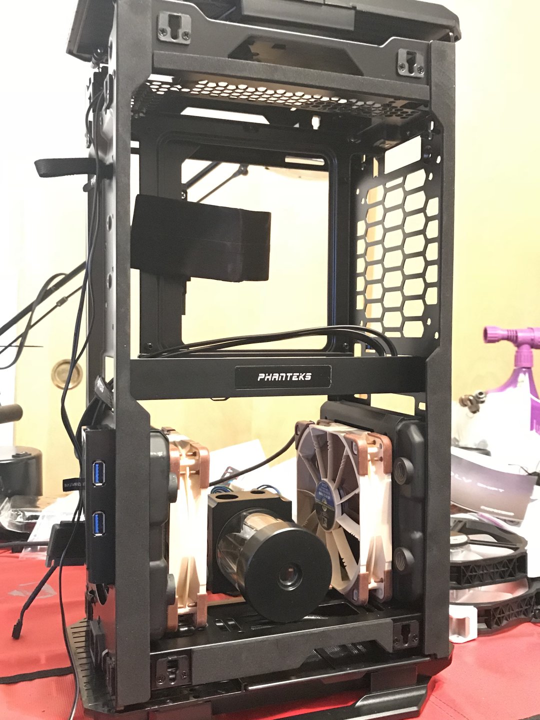

My case arrived yesterday. Bad news: subtracting radiator height (30mm) the vertical clearance of the bottom chamber is just 120mm. There is no way I can cram the Magicool DCP450 above the bottom radiator. Good news though: The area reserved for the bottom fan has a height of around 28-29mm. So, if I place the radiator there instead of the fan and then the fan above, which is 25mm instead of 30mm, I just get enough clearance to put the 125mm Magicool also in. This is going to be a tight fit and I don't know yet how to fill water into the reservoir, because there is no chance to fill something in from above, besides drilling a hole in the middle cable management area. Will have to figure that out. Another downside: There is barely enough clearance for the Nemesis GTS 120 radiators if they are placed at the designated spots. You will most probably scratch the finish when installing them. And there is no way to place one of them in the bottom fan spot. That's why I ordered two Magicool G2 Slim radiators. They are half the price, but not bad in reviews. And they will hopefully fit.
Thanks for the update. Are you open to (or see any opportunity to) modding the case to fit the components?
I don't know the entire product line of EK, but this one combo of pump and reservoir, I know, says <120mm for the height in the specs. You may have to get creative with mounting, but I think you can make it without modding. I am not very experienced with modding. If you cut the bottom mounting plate, you lose the mounting hole and do not gain a lot of flexibility. You cut cut the cable management area in the middle, but then the board mounting plate would hang freely and again, it wouldn't gain much height.
Nevertheless, as announced, I will try to mount the radiator in the bottom fan spot and therefore I will have to cut holes for the fittings conflicting with the bottom mounting plate. In addition I will have to cut the middle structure in the PSU area to fit any PSU, because I wasn't happy with the choices left leaving the structure in.
Not really an update. Just a test fit...
It is hard to tell from this one picture, so correct me if I'm wrong, but it looks like the bottom rad would get in the way of a fan, that should be added to the side radiator, right? Do you have a plan yet how to mount the pump?
In the meantime I was also thinking about my problem with the magicool pump. I came up with the idea of mounting it like in your picture, but 90° rotated along the vertical axis, meaning: it would point towards the glass side panel. Not the optimal solution from an asthetic point of view, but it might work without cutting holes in the case. Also the problem of filling would be solved.

I did a bunch of test fit with various fans and radiators, but no components yet... I still need my current PC, and wanted to have a solid plan build tearing down current build. Here’s some documentation...
XSPC on the front, HWL (these things are sooo wide) on the bottom:
15mm slim 120mm fan can potentially fit in place of the SSD mounting spot. Just need to cut venting:
A 25mm thick 120mm might fit if I cut out a full 120x120 opening at the SSD wall:
A slim 120mm could fit here, with front cover fully close, but zero air flow:
240mm radiator held up by a 120mm fan on inside:
Inside view:
240mm radiator ports blocked by front wall. Will need mod if I go this route:
A 280 can fit on the front wall. It does but the bottom half of the radiator will not get full 140mm of air:
Curious to see if some sort of double 120 radiator would fit. Yes but where would PSU go?
