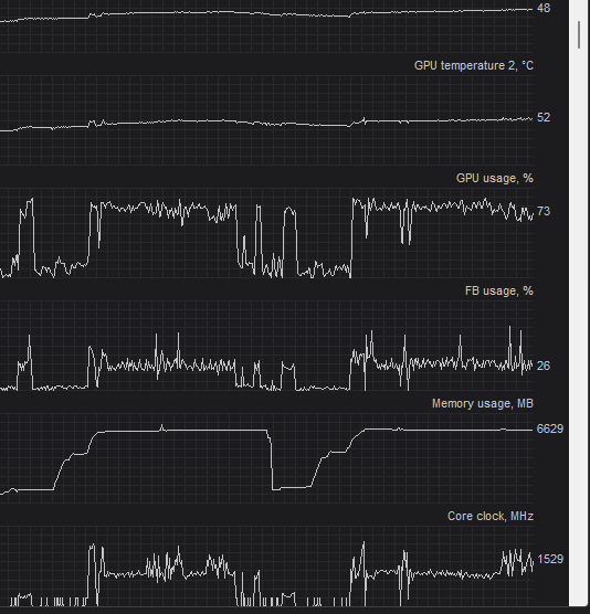

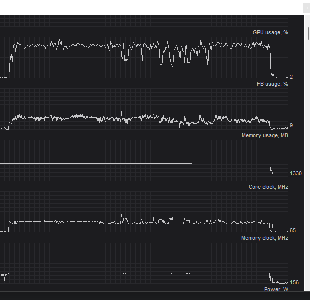

You are actually seeing it, it shows up different degrees depending on the game (I'm talking about cpu limited gaming). As for cpu limitations, my 10700T+1660ti is about as fast as my 5900x+6900xt at 1080p. Yes, my power limited 10700T@about 3.8 ghz.
*note in a specific spot in my base, that represents a good percentage of the game* People who play fallout 76, know exactly what I'm talking about. (fps swings in fallout 76 are pretty wild, especially depending on lighting/shadows)
at 1440p my 6900xt destroys the 1660ti for obvious reasons.
I have a specific spot in my base that I stand on. So it's fairly repeatable.
Yes, fallout 76 is very single core thread heavy and poorly optimized. That doesn't change that it's a game I play and enjoy... unfortunately. :confused:
It also doesn't change the fact that my 6900xt gets 50% less fps than my 3070ti did. Nor does it change the fact that both the 6900xt and 3080 are cpu limited.
6900xt@ about 1200 (full screen, with/without cool, fps limiter, etc

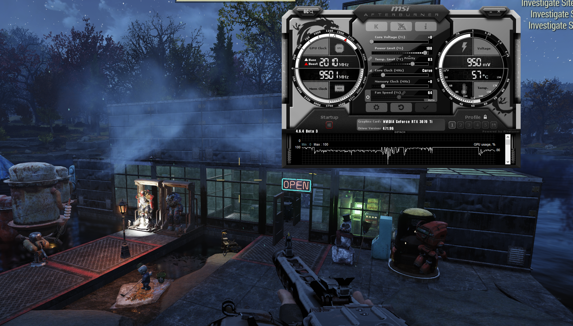

1440p (everything maxed) even min core limiting it, I get the same fps
rtx 3070ti
core stays 1970-2010 (I don't have it anymore so I can't exactly show the same picture)
My base
*yes the 6900xt full upper fps swings are much higher, but it makes no difference when your mins are garbage*

However, I just tested this on
Crysis 2 Maximum edition, shows good gpu usage... till you look at the frequency. 5-700mhz. *note I haven't played around with settings, but as is default this is what I got*
He gave an example as did I.
I’ll give that a try. His examples were mostly MMOs- I don’t play those. Can’t judge new world or war frame or fallout money-grab edition.
