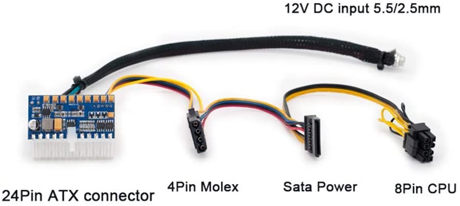

Are you using an HP/DELL server psu with breakout board? I ran this setup for a while using 6x RX 570 8GBs and one 900w/1200w HP server PSU without any issues.
  1. Use a Pico ATX PSU to power the 24-pin/8-pin CPU and SATA drive
  2. Connect molex from Pico PSU to server PSU's breakout board to jump both PSUs on power button press
  3. This works best assuming you're powering all your cards with powered pcie risers
https://www.amazon.com/RGEEK-24pin-...1_1?dchild=1&keywords=pico+psu&qid=1628875357

Cards are powered by risers. Mine does not have a breakout board therefore I'm just limited to the cables that come out of it.
dont think you can, its meant for a certain board. its also not a server psu, its a mining psu.
Yeah what pendragon1 said or you can find the pinout similar to a 24-pin ATX connector and use the paperclip method to jump it. You might need to ask mineshop for help on that.
