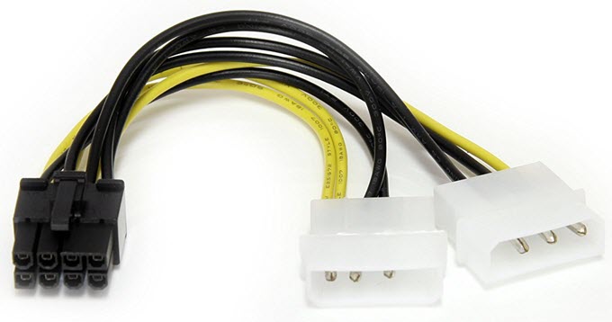

Look for the black connector on the left side of this coming out of your power supply.
Some graphics cards require two. Most will have six wires, with two more off to the side that combine to form 8.
If your PSU doesn't have any, but does have molex, you can use that device below to convert molex into a PCIe Connector.
However, a 180 watt power supply will likely not be enough for even the weakest graphics cards.
Being a prebuilt computer, you might also find it difficult to upgrade, if it uses non-standard size specifications for the PSU.
If you do a lot of research, you might still find an answer.
Hi Aegir thanks for replying. Inside the PC there is one spare power cable, it is marked SATA PWR - in pics 3 and 4. Also, the DVD drive is unused so I can repurpose those cables somehow - pic 5. Can I use any of these cables to power the graphics card, if the PCIE slot is not enough? Or is it not even worth doing that because the PSU is so low powered? Im definitely not upgrading the PSU as it is firmly attached in, and dont want to risk it
