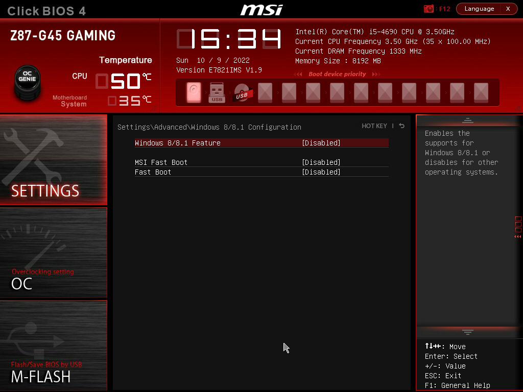

I disabled msi fast boot and fast boot - it does not make any difference to boot time.

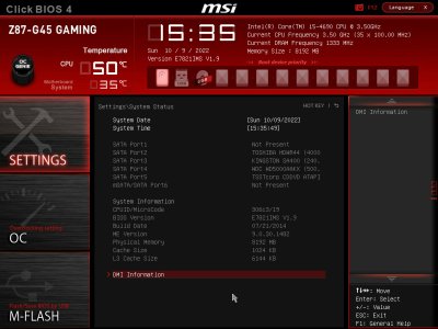

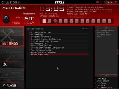

I don't see the "sata device support" option.

I hit the "pause" button when i saw the msi logo screen and I waited 30 seconds then i hit enter - it does not work.
