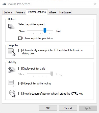

Hello,
I have Logitech mouse with DPI of 1000 and there is no DPI switch.
Windows has option to control mouse sensitivity and "Enhance Pointer Precision" feature.
I am wondering what are pros versus cons when using mouse with DPI range switch and controlling
sensitivity with "Enhance Pointer Precision" feature.
I used to hear that in general controlling on a hardware is always better than on a software level (which Windows is)
so does this apply to mouse too? Would I better use DPI switch on a mouse versus above mentioned feature in Windows?
Thanks
"Enhance pointer precision" applies heavy acceleration to mouse movements. It's not what you're after and is a bad thing for being precise with your mouse.
DPI Switch on a Mouse, this is useless at MX518.
When mouse DPI this set correctly according to screen size (dimensions), then this is not required to be changed again, 2D and or 3D.
Windows mouse acceleration this gets disabled at modern games.
At 1080P, 1000 DPI are enough.
But a modern sensor as is 16K Microsoft Pro IntelliMouse ( wired), this will deliver much more smooth performance at 1000 DPI, especially when this gets calibrated according to mouse-pad.

You want it off. You also need to change the pointer speed notch. I made a guide for this.
https://eliteownage.com/mouseguide.html

You aren't taking advantage of the DPI, but the sensor will still be more accurate. Newer sensors are more accurate than the older ones. For example if you move really fast an older sensor may have only be 95% accurate whereas a new one could be 99% accurate.
Adjusting the windows sensitivity setting to anything other than 6/11 will only make it less accurate because windows doesn't store the cursor's position in fractions of pixels, only whole numbers.
In a game like an FPS with mouse look you can lower sensitivity and increase DPI to get more precision because you're turning your view N degrees times dots sent from the mouse.
