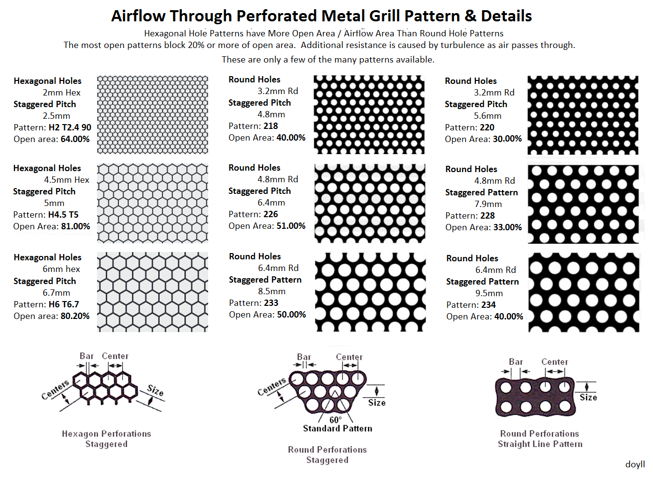

Another problem is how restrictive not just filters, but grills and even pressed metal mesh or wire ring grills are quite restrictive. See next post.
Grill & Filter Effect on Airflow & Noise level
Click on to view
http://www.silverstonetek.com/techtalk_cont.php?area=en&tid=wh_chessis
Scroll down to see how air flows through round wire grill versus punched metal grill.
Click on to view
https://www.pugetsystems.com/labs/articles/Effects-of-Grill-Patterns-on-Fan-Performance-Noise-107/
Here is a drawing of basic grill mesh designs showing what their open area / airflow area is. Notice hexagonal / honeycomb patterns have much more open area for air to flow through.
