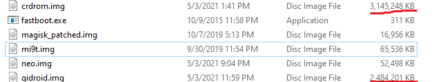

Interesting fact, between crdrom (A11) and qidroid (A10) there is quite big difference as image size. Wonder what things included do such big difference. Anyone knows? May be only gapps included in different ways?

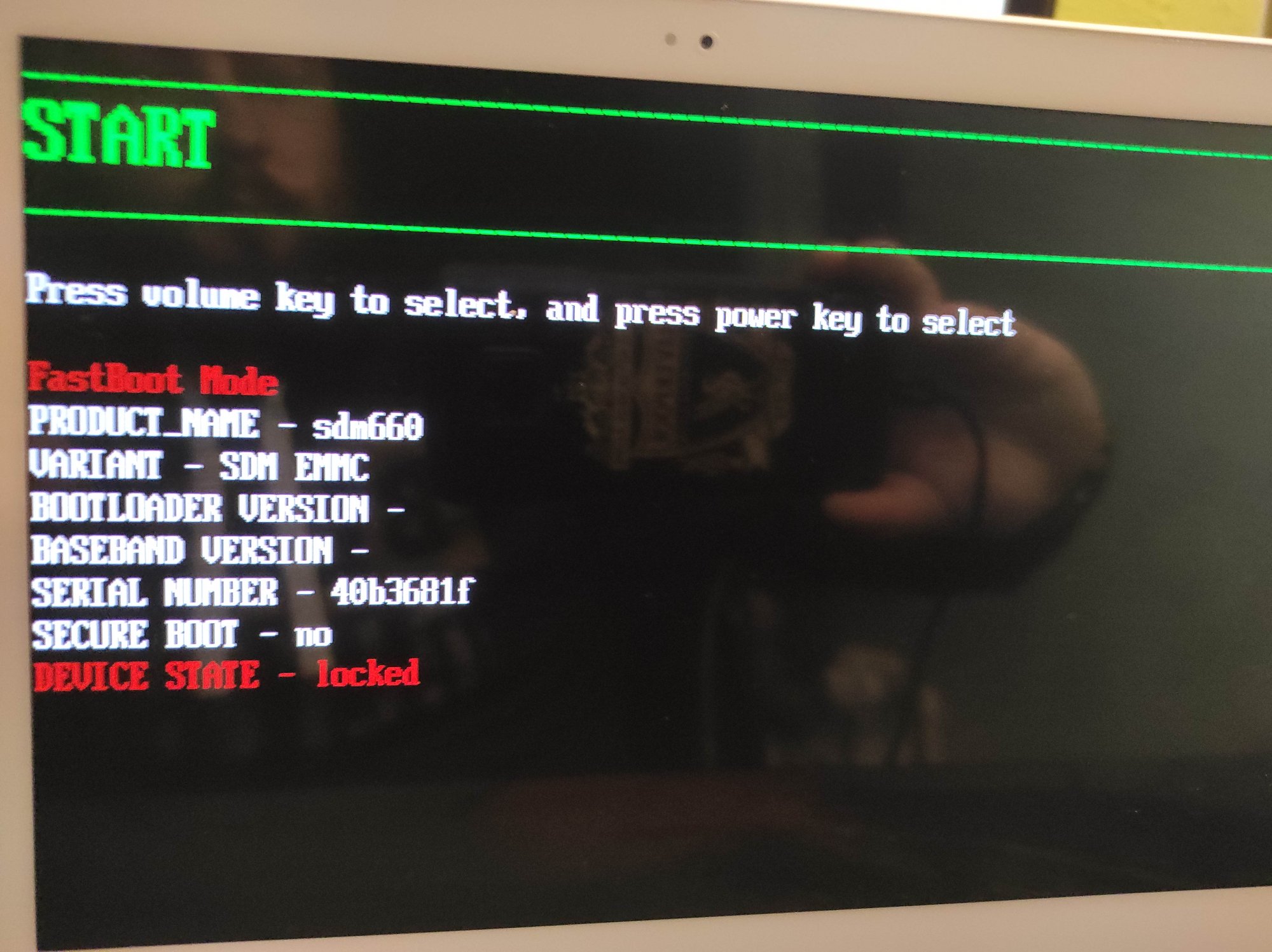

Then perhaps you don't have your tablet in bootloader-mode. :) It must look like the picture below. If you use Windows, what kind of device is shown in the device-manager after the tablet in bootloader-mode is connected? It should show "Android Bootloader Interface" or similar.
