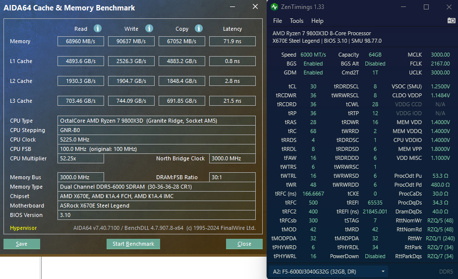

I've got a pretty cheap pair of 32GB DDR5 sticks and I've always used Buildzoid's easy tweaks to get some extra oompth. Someone posted on reddit with similar sticks to mine so I have been down the rabbit hole a bit of tweaking. Mind you - I am still 100% a memory OC noob...but I feel I am getting there a bit.
Been tweaking my SCLs from 4 to 8 and to 4 and then 8 back again - it gets me better copy speeds at the 8 number which is strange (Buildzoid recommends 4). Flipped VSOC from 1.20 to 1.25 - not sure if I needed that but dude I was trying to emulate on reddit had it and he has the 2167.00 FCLK like I have.
tFAW I just futzed with because someone recommended it...when I went back to 20 I saw a regression so back it went to 16. It has been stable. Just small OCCT runs for stability and of course running the AIDA64 cache & memory bench.
Any other tips? Having fun which is the most important thing. :)

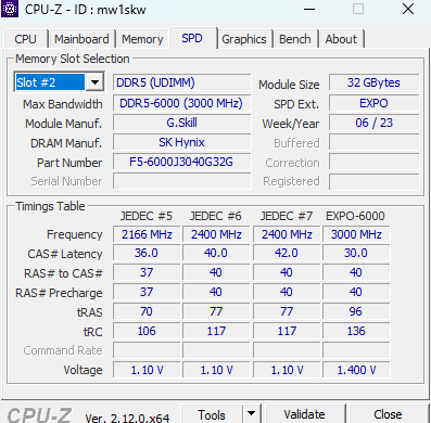

My RAM:
G.Skill F5-6000J3040G32GX2-TZ5N​
G.Skill Trident Z5 Neo
DDR5-6000 CL30-40-40-96 1.40V
64GB (2x32GB)
AMD EXPO
https://www.gskill.com/product/165/393/1665020366/F5-6000J3040G32GX2-TZ5N

OK got my 2nd 9800X3D rig dialed in the same as the first (same memory kit, same CPU, different board - X670E Taichi for this one versus X670E Steel Legend for the last - also much better cooling with a 280MM Arctic Liquid Freezer III).
Platinum OCCT certification - https://www.ocbase.com/stabilityCertificate/674839ed8f4c643478234ba5
Karhu (9+ hours - was off at Thanksgiving or it would have been shorter, haha)
Prime95 Large FFTs (2 hours)

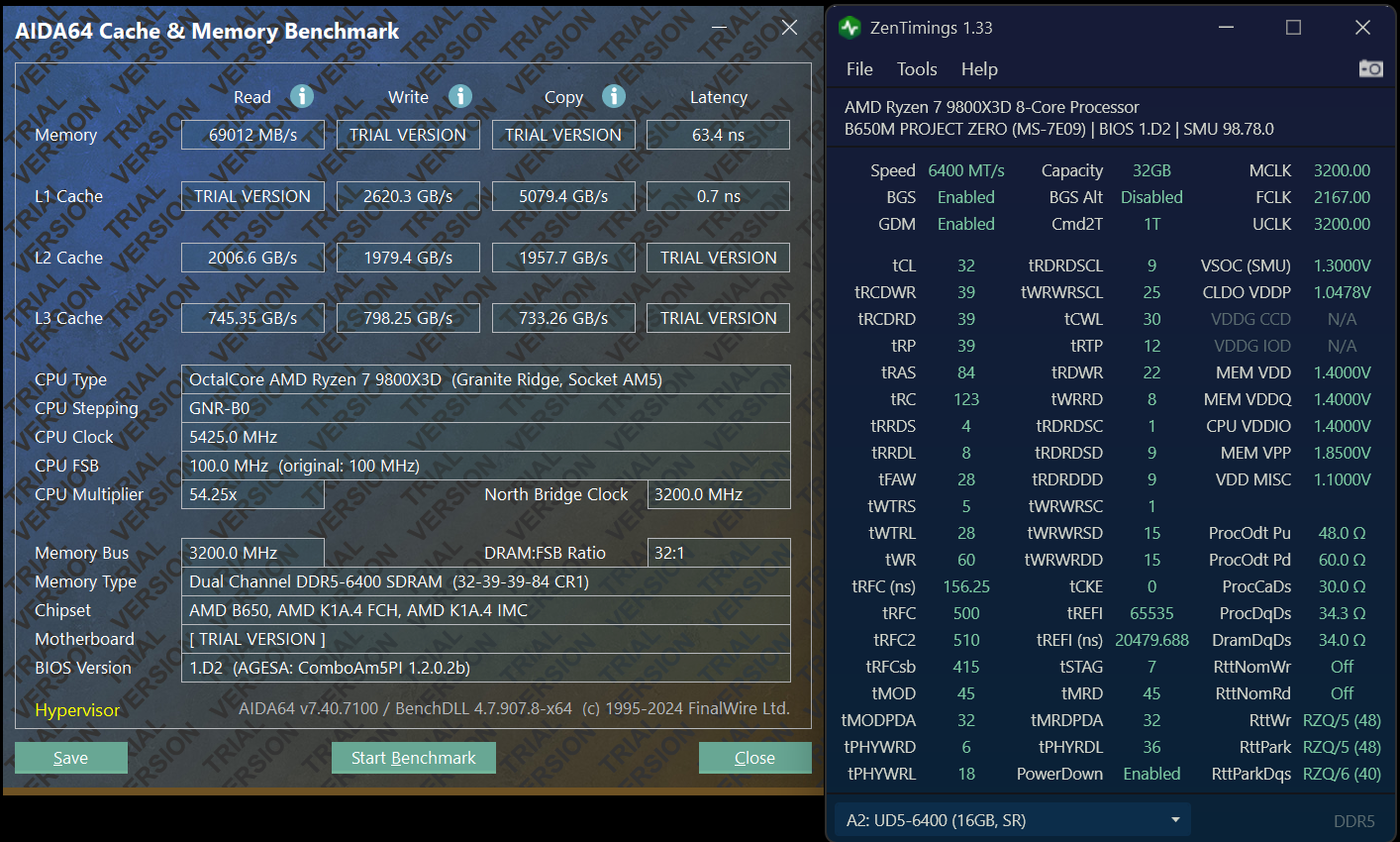

So, adding my timings with my 9800x3d. I decided to use the new MSI memory timings set to tightest. Wish I could use adjust the eclk, but can't with this motherboard. Gotta say this is a damn good CPU.
Awesome results! Did you try to push FCLK up at all? You should be able to hit 2167 MHz. I had a ton of problems trying to get to 2200 MHz.
yeah I did try 2200 and it was a no go. Once I hit 2100 and saw these results, I was like...ok im good! lol.
I can give it a shot and see how it goes.

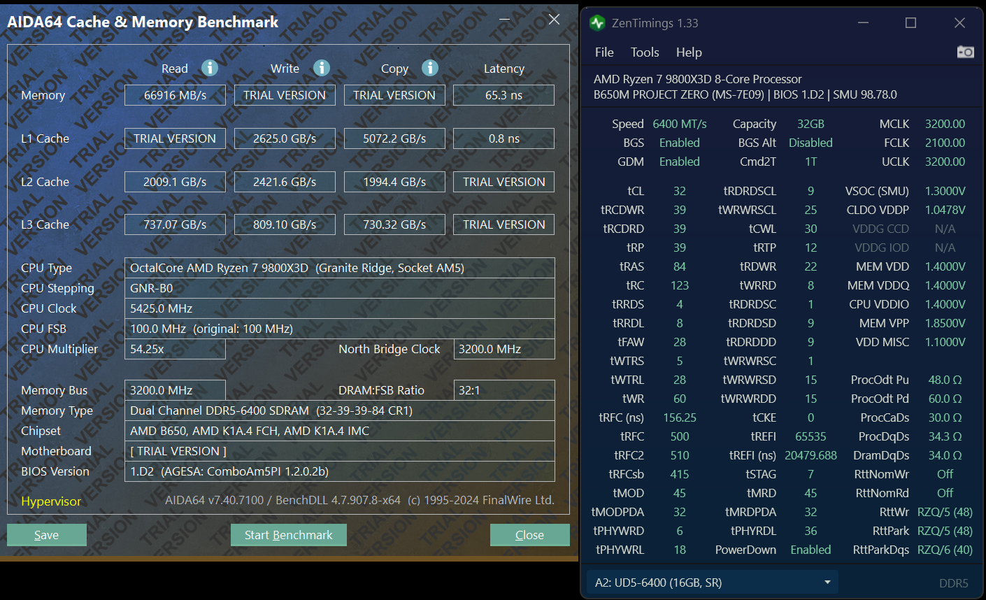

Here are my results for my 9800X3D. I have a couple insights to add about timings as well.
tRFC, tRFC2 and tRFCsb should all follow the same proportions as their stock timings. They are like gears in a vehicle or a watch, and always follow the same ratio. So if you want your tRFC values to be 10% faster, then multiply tRFC by 0.9, tRFC2 by 0.9 and tRFCsb by 0.9, the point is that they need to remain aligned. I subtracted 30 from the tRFCsb (think of it as minimum tRFC) with each step and then multiplied that number by the stock ratios, so I had 195, 195 x 1.230767 = 240 and 195 x 2.26667 = 442.
tREFI should be no higher than 4X the stock timing, anything higher than that is a waste and can create instability.
How is your memory latency so good? And how did you get tRp and tras so low??? My trp is unstable at 94 cycles at 1.41 volts, 6200MT/s, G.skill flarex 6000mt/s C36-36-36-96. My latency is 85ns, FCLK 2200MHz. With stock EXPO settings the FCLK2200 is 100% stable in P95 large FFTs, tested for 2 hours, 2 minutes per iteration.
