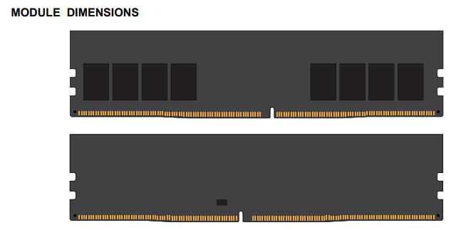

Interesting that would be a positive since DDR4 kits are all over the place. First of all amazing info from Kingston. Most manufacturers are complete piss with their ram details. You might have to hop around to websites looking for reviews. Corsair is kind meh for info, team group good luck. Kingston though most impressive they have pdf's on most sets.
IE: the DDR4 set I ordered KF436C16RB1K2_32
However another common DDR4 3600 kit from Kingston: KF436C18BBK2/32 single.
Anyway, this has been super annoying in searching for kits to find dual rank and c16 kits at an affordable price. What would be the equivalent in DDR5 to cl14 3200 kits which seem to be the holy grail of DDR4, CL36 6000 or something? I know this is sort of off topic but I've only recently started looking at ram more.
