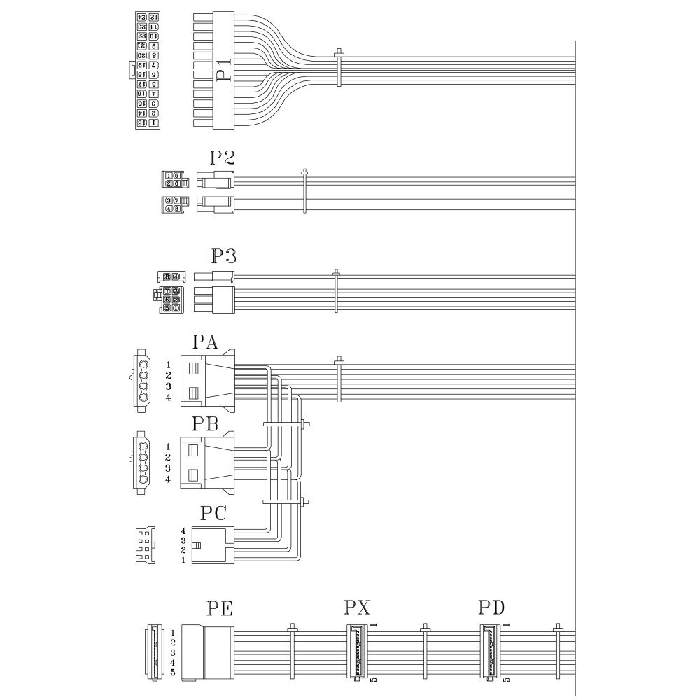

7. First version of drawing complete!
Today I've finally completed a first version of the drawing! Link to PDF.
If anyone finds a mistake or has objections, please tell me! The division of connectors to the 12V rails is not final, everything else seems pretty much fine to me.
I'll add this to the first post so people can find it easily.

Hey look! This is the SSP-300SUG, but it's not really all that "modular". You can see the cable harness a few pictures in.
Do/could they they tie up like-wires at the point where the modular cable meets the psu to reduce a 24-pin connector to an 8-pin? If not, why not?
We'll do a little bit like that, but the main limit is how much current the connectors are rated for. For example, an 8-pin PEG connector has 225W rating. At 12V, that makes 18.75A. As an example for a connector, let's take the Molex MiniFit Jr., which is used for ATX24pin, PEG, EPS12V and modular connectors on PSUs. The maximum current one pin can carry on that is 13A. As the same amount of current passes through the +12V and the GND pin on a connector, a 2pin connector could supply a maximum of 13A, or 156W.
So for PEG, we need at least a 4-pin connector, else the pins might melt or the resistance on the connection increases so much that the load skyrockets and the PSU shuts down.
When looking at a realistic ATX connector replacement on the PSU, we can't just connect all 5V pins on that to a single pin on the PSU, we need to use multiple to make sure we stay within spec. We also need the three control signals and the number of ground pins should be very close or the same to the number of voltage pins to make sure the current can flow back to the PSU through the connector and not through the case.
With ATX in particular, there's the problem that the maximum power draw isn't specified in the standard, so we have to guess what a reasonable reduction in pin count is. The minimum I would go for is 12 pins. 2*3.3V, 2*5V, 1*12V, 4*GND, 1*5VSB, 1*PS_ON#, 1*PWR_OK.

Modularity and cables:
So the current state on this is as follows:
There will be no modular connectors on the PSU itself. The poll clearly showed that there are cases where less than 20mm of space will be available in front of the PSU. Most importantly, the Hutzy XS will be quite limited in that area, and it is one of the most popular planned builds that involve this PSU. So even if flush modular connectors were possible (which they aren't), installing the PSU in such cases would be a nightmare or straight out impossible.
But, to redeem this, the SATA, PEG (GPU) and EPS (CPU) power connectors will be on very short cables, which can be extended with any old extension cable from the store, no need to mod anything or make your own extension. These short cables also allow configurations where devices are sitting very close to the PSU and will use up minimum space for people who don't need them at all.
The ATX cable will be long enough to support pretty much all configurations but as short as possible to prevent cable clutter in situations where the ATX connector is close to the PSU.
The current lengths for the cables are:
SATA/PEG/EPS: 8cm
ATX: 18cm
The is the next-best thing to semi-modularity we can get.
The following connectors will be present on the PSU:
SATA: 1x or 2x
PEG: 1x 6+2pin, 1x 6pin
EPS: 1x 4+4pin
ATX: 1x 20+4pin
I'm still a little torn on the SATA connectors. On one hand, more than 40% claimed to be using two SATA-powered devices, but on the other hand even more people will be using one or zero SATA devices. So it seems like having one connector and including a splitter seems like a good middle-of-the-road solution, but maybe there are differing opinions.
Two 6+2 pin connectors will not be possible, though. The limitations on the power draw are just too tight. It might still be doable if you use an adaptor, but you'll be doing that on your own risk.
So, that's it for now. Things are looking good, as far as I'm concerned. I will go on vacation on Tuesday, so don't expect any further updates during that time. I'll have internet, though, so I should be able to reply if you've got any questions or concerns. Have a nice day and thank you for reading!

For the Hutzy XS & the quoted cable lengths, it seems like they should be reversed (excepting the SATA, I have no need, so the shorter the better there)…
The vast majority of mITX MBs have the 24-pin MB connector immediately adjacent to the PSU cabling in the Hutzy XS, and the CPU/GPU cables would automatically require extensions to reach their intended components/sockets…?
Shake My Head…
My bad, I've been following this since the start and only rely on the 'new' tag to read posts... maybe I missed couple. But thanks, I found the info.
Anyways, personally, I would not be needing any SATA/IDE connectors (11%). So I'd prefer that cable be as short as possible. Another cable would be the PEG, only 1 of them will be used. I suppose it's a trade off between ease of manufacturing and additional extensions.
I read the GPU as one cable with two connectors, rather than two cables…?
I M lao in the zero SATA cables needed crowd; M.2 Master Race…!
Well yes, for the Hutzy XS the perfect configuration would look different, but it's not the only case that will be using this PSU (*cough* Brevis S *cough*), so we had to find a compromise that suited most configurations. I talked to Hahutzy about it, and we agreed that extensions would be feasible for the PEG and EPS connectors, as there's room below the GPU to fit them in.
The ATX cable could be shorter, but that would hurt a lot of other layouts, and I don't want to require most people to use an ATX extension. 18cm is the longest possible for the Hutzy and the shortest that allows all mainboards to be connected, no matter where the PSU is, as long as it's adjacent to the MB.

So, is the GPU (aka PEG) cable a SINGLE cable with both 6+2 & 6-pin connectors, or is it TWO cables (one 6+2 & the other 6-pin)…?
I was reading the previous posts as it being a single cable with two connectors (okay, technically THREE if you count the 6+2 as two separate connectors, which they are)…
Regarding extensions, I am wondering if it might be less bulk to splice in the additional needed cable (per wire, staggering the splices, I would use those crimp-on style "splice" connections, staggered to avoid too much bulk in any one given spot), and shortening any too long cable (hello, possibly too long 24-pin) and crimping on new pins to the shortened wires…?!?
Thank you & Hahutzy for doing this work on optimizing the FSP 500w PSU for us all; even though I may ask stupid questions and make ridiculous demands, it is very much appreciated…!
That's not set in stone yet, but I'd like to have them as a single cable if the rails turn out to only support either 8 or 6+6. If I find a way so that 8+6 pin GPUs can be supplied reliably as well, then they'll be on two cables.
I'm not quite sure I know what connectors you mean. Do you have a link or a picture?
My pleasure :) Getting ridiculous and physically impossible suggestions helps know what people would perceive as the optimum, so it's more valuable than you might think.
Ah I see. Yes, those would be less bulky than using regular extension cables because as you said, you can stagger them to decrease the maximum thickness, and they are shorter than a complete female-male connection with MiniFit. So if you want to extend the cables to the perfect length but don't want to solder, those are a very good option.
But when shortening, especially if you're going to shorten the ATX connector, just cutting the wires and re-crimping the connector would be a much cleaner and more space efficient solution.
You are correct, adding lengths of wire & soldering the joint connection (along with heat shrink over the solder joint area) would be best…
Towards the 24-pin, I would do as you say & cut the wires to length & crimp on a new pin to each shortened wire, then reset in the connector…
