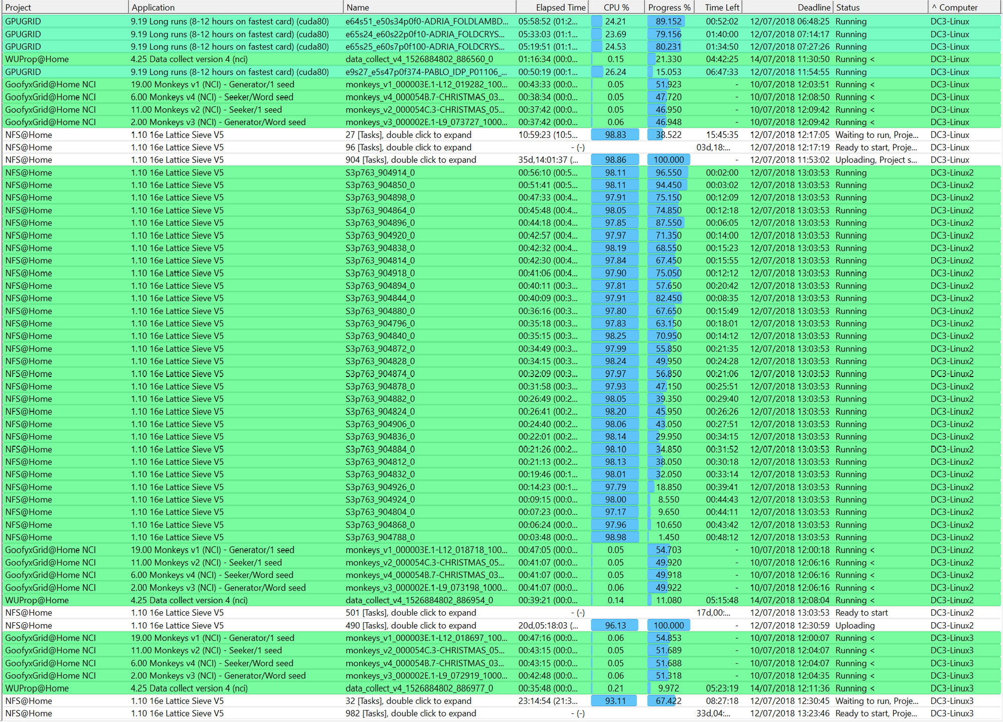

Screenshot is a Threadripper with 3 boinc instances currently brewing an NFS bunker. The only gpu project I've tested so far is Primegrid. It seemed to work fine.
Additional boinc client instances may be the way to go on this one. They allow you to crunch both cpu/gpu and are less resource hungry than VMs.
I looked into this following the comment from ChristianVirtual on his success using this approach last year. The guide I used was written by OCN's mmonnin and tictoc here.
According to TAAT's Stefan the only currently active project he's come across that it can't be used for is GPUGrid.
