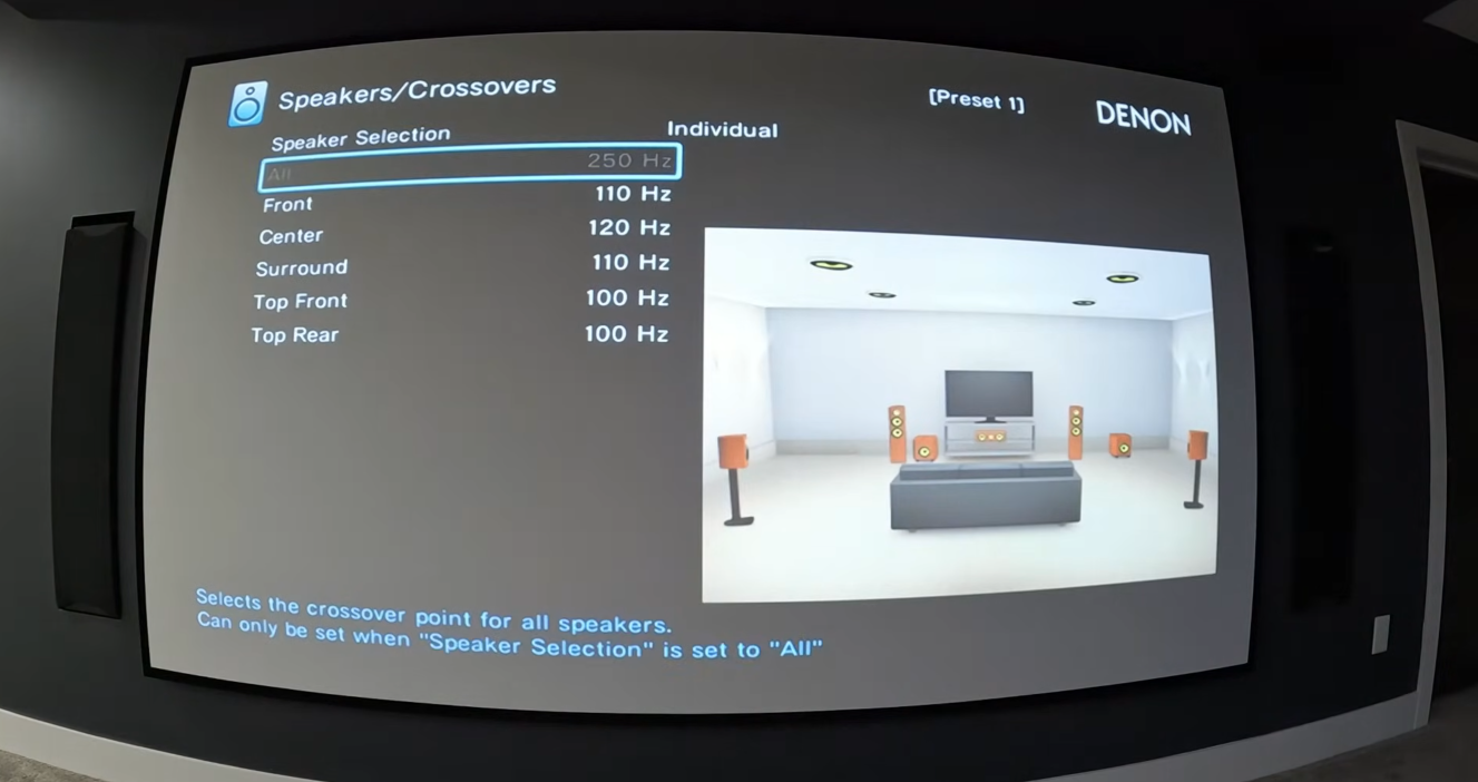

Here is where I recommend you set your crossovers
I do use Dynamic EQ but I recommend most folks turn it off.
If you want to get into the weeds turn it on and use a 10 db offset for streaming and 0 offset for Blue Ray or physical media.
I still say 200 hz for the Bose but honestly you need an upgrade there too those are 20+ yrs old and like have damage to their surrounds causing most of your lackluster sound quality

I’m going to take your advice and do this in stages before I spend money blindly. First step is getting the subwoofer back to proper working condition. I ordered a reconditioned replacement backplate/amp assembly directly from MartinLogan, so once that comes in I’ll be able to use the proper LFE input again.
After that, I’ll probably reset the Denon, start fresh, rerun setup/calibration, and then verify everything manually afterward.
On the crossovers, I’ll likely test the Bose Acoustimass cubes around 200 Hz first and compare them to 250 Hz. I understand what you’re saying that 250 may be high, but since these cubes are not being used with the original Acoustimass bass module, I’m being cautious with how low I cross them. The Bose 101 surrounds I’ll keep around 100–120 Hz. I have tested the cubes at 180Hz and the 101's at 150Hz. They actually handles it and added some noticeable deeper mids to the voice and overall sound. It's just that I was told by almost everyone that they will blow at that frequency range.
Dynamic EQ is something I’ll test both ways. For the first clean baseline, I’ll probably leave Dynamic EQ and Dynamic Volume off. Then I may try Dynamic EQ on with the offset like you suggested, especially for streaming/TV. I do most of my watching through Fios/streaming, not much physical media.
And yes, I agree the Bose speakers are probably the weak link at this point. Whether they are actually damaged or just limited by design/age, I think they are holding the system back. I’m just trying to make sure the subwoofer and Denon setup are right before I make the final speaker decision.

Before I spend money on Dirac, I want to fix the known hardware issue first. I ordered a replacement reconditioned backplate/amp assembly directly from MartinLogan for the Dynamo 500, so once that comes in I’ll be able to use the proper LFE input again. After that I’m planning to reset the Denon, start fresh, rerun calibration, and manually verify the speaker sizes, crossovers, distances, levels, and subwoofer settings.
I agree with you on the Bose. They served their purpose, but they are older and definitely not in the same class as what I’m considering now. I don’t expect Dirac or Audyssey to turn those cubes into something they’re not. I’m just trying to get the receiver/subwoofer side right before I make the final speaker decision.

Thanks again. My plan right now is: fix the sub input, reset/recalibrate the Denon, listen again, then decide if I go Dirac, new speakers, new sub, or some combination of those.
