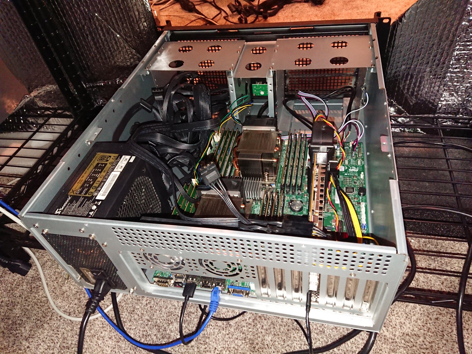

Mind the fan cable mess, they have individual cables for each fan and are PWM controlled via the mobo/bios (the top card runs a bit hotter/higher fan speed).
