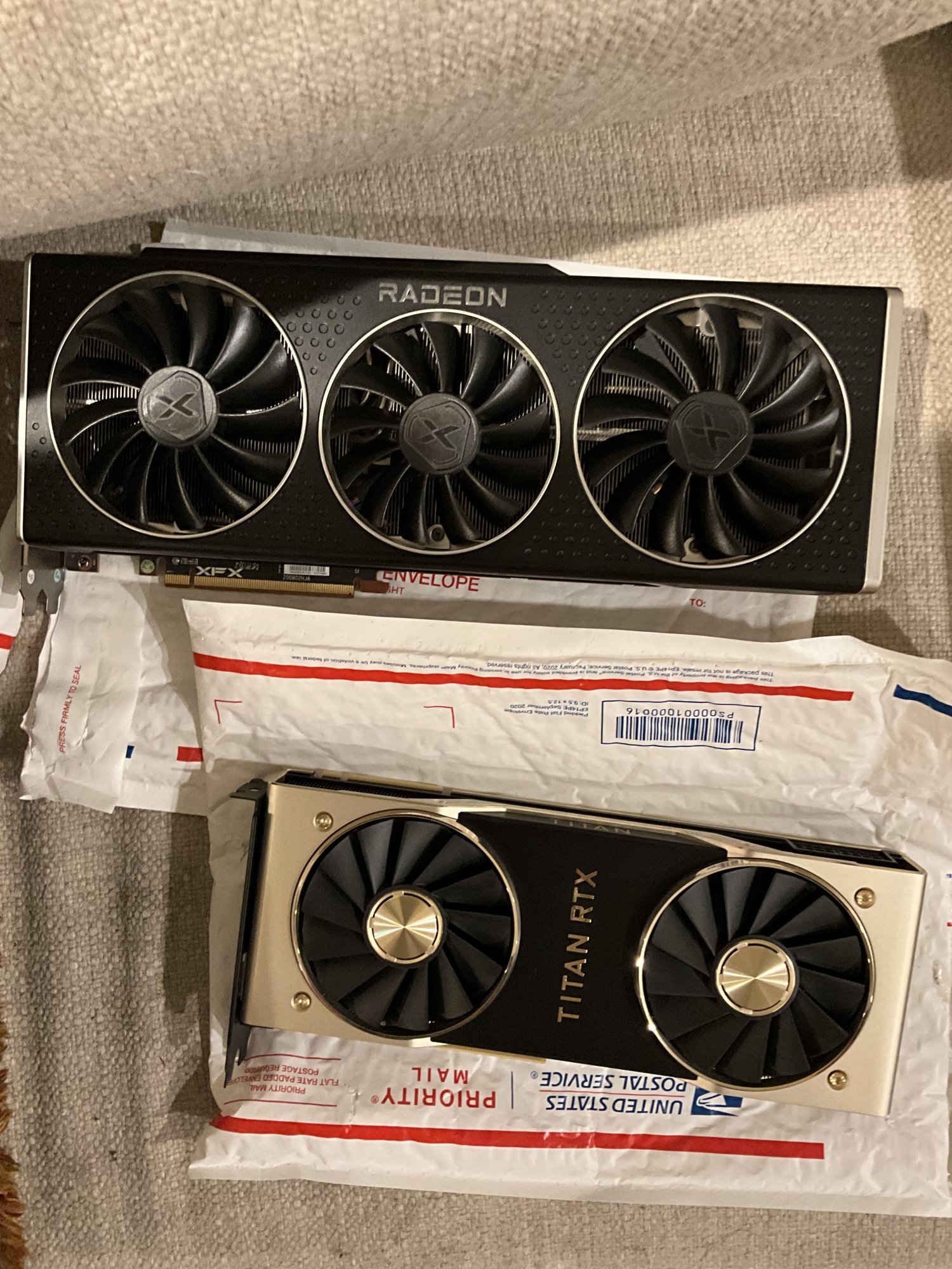

Always have a backup for your backup. So far so goods with the power cable. Wattage seems stable so far...knock wood.
