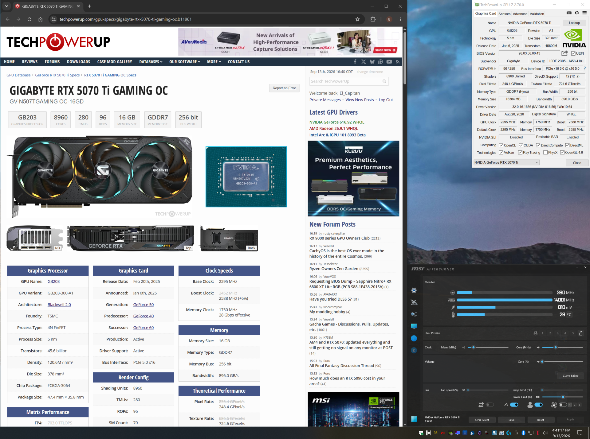

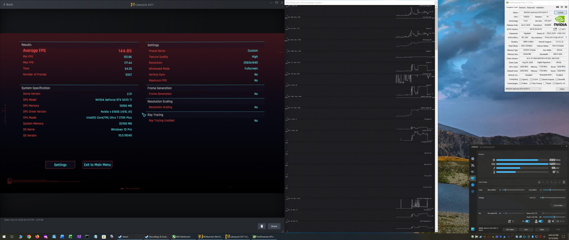

She's a good overclocker. Not the best, but definitely above average. MSI Afterburner +460 for the best score in Cyberpunk2077, but +470 had a slightly worse score, and +480 crashed. Gets up to 3300MHz peak Core Clock.
Geekbench 7 Stock:
Geekbench 7 +460 OC:

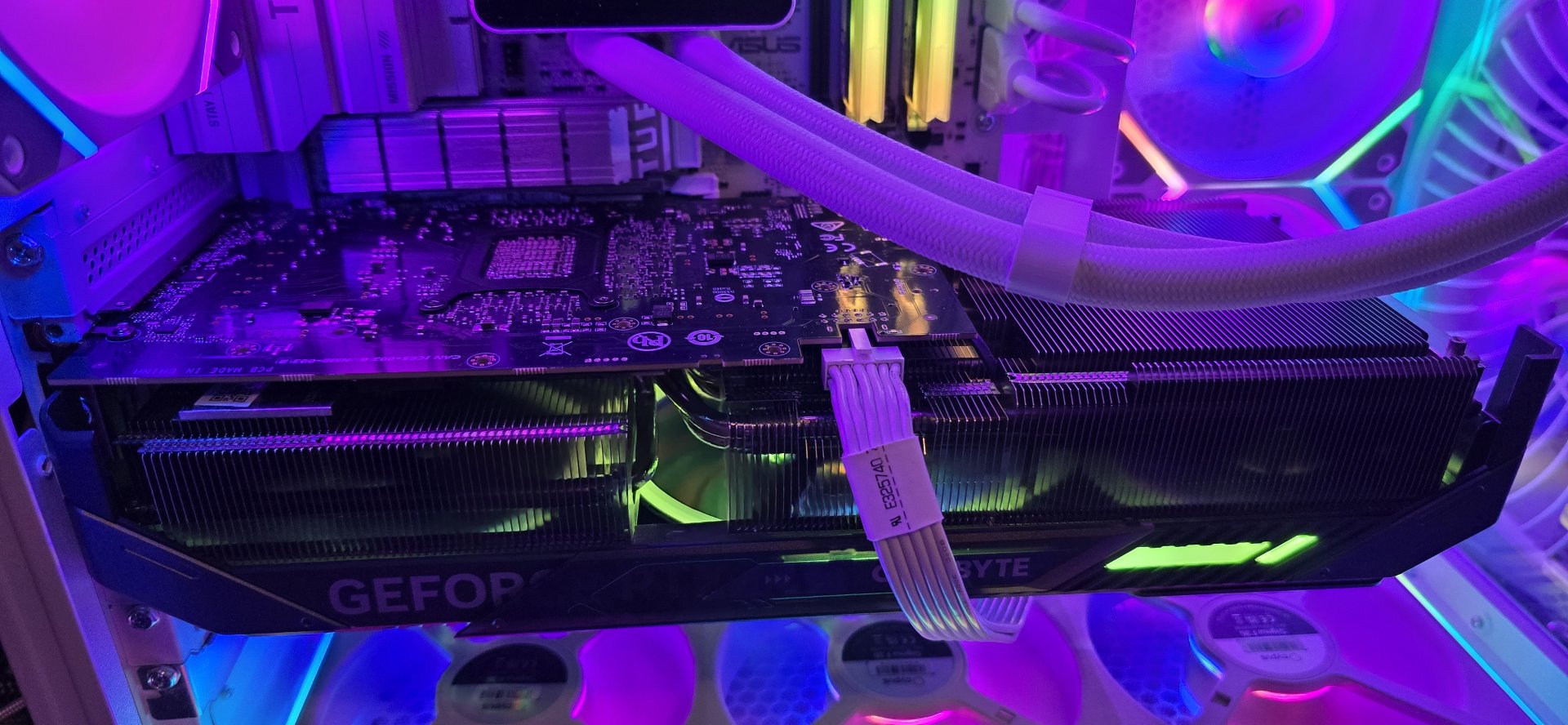

Not the best job in the world, it's been decades since I've repaired electronics equipment, and now that I'm older, my eyes aren't what they used to be. Everything's a lot smaller now, and I don't have the best equipment. I ended up putting hi-temp masking tape between the new fuse and the graphics card cover just in case. There's only a slight bend now near the Displayport/HDMI connector end, but the PCIe slot is straight.
That fuse is way too close to that other smd thing. Good job!
The picture is just at a weird angle, it's still maybe a cm or two away from the fuse. Still, it wasn't an easy repair with just a 20x magnifying glass and a 60V soldering iron with a somewhat fine tip. I tried with 350W hot air, but the solder on it wouldn't melt. I pretty much had to clip it off, then solder as little as I could on the ends with the soldering iron. It's still a bit too raised.
those things have fuses?
Good to know that is working!
