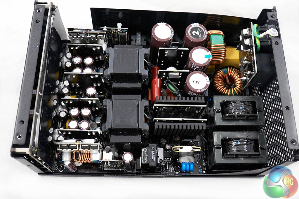

https://www.kitguru.net/components/power-supplies/zardon/superflower-leadex-titanium-1600w-review/
Many changes have come over the years that cause a PSU change.
but this psu is baller across all rails in terms of power delivery
it’s solid. it’s not the psus fault
