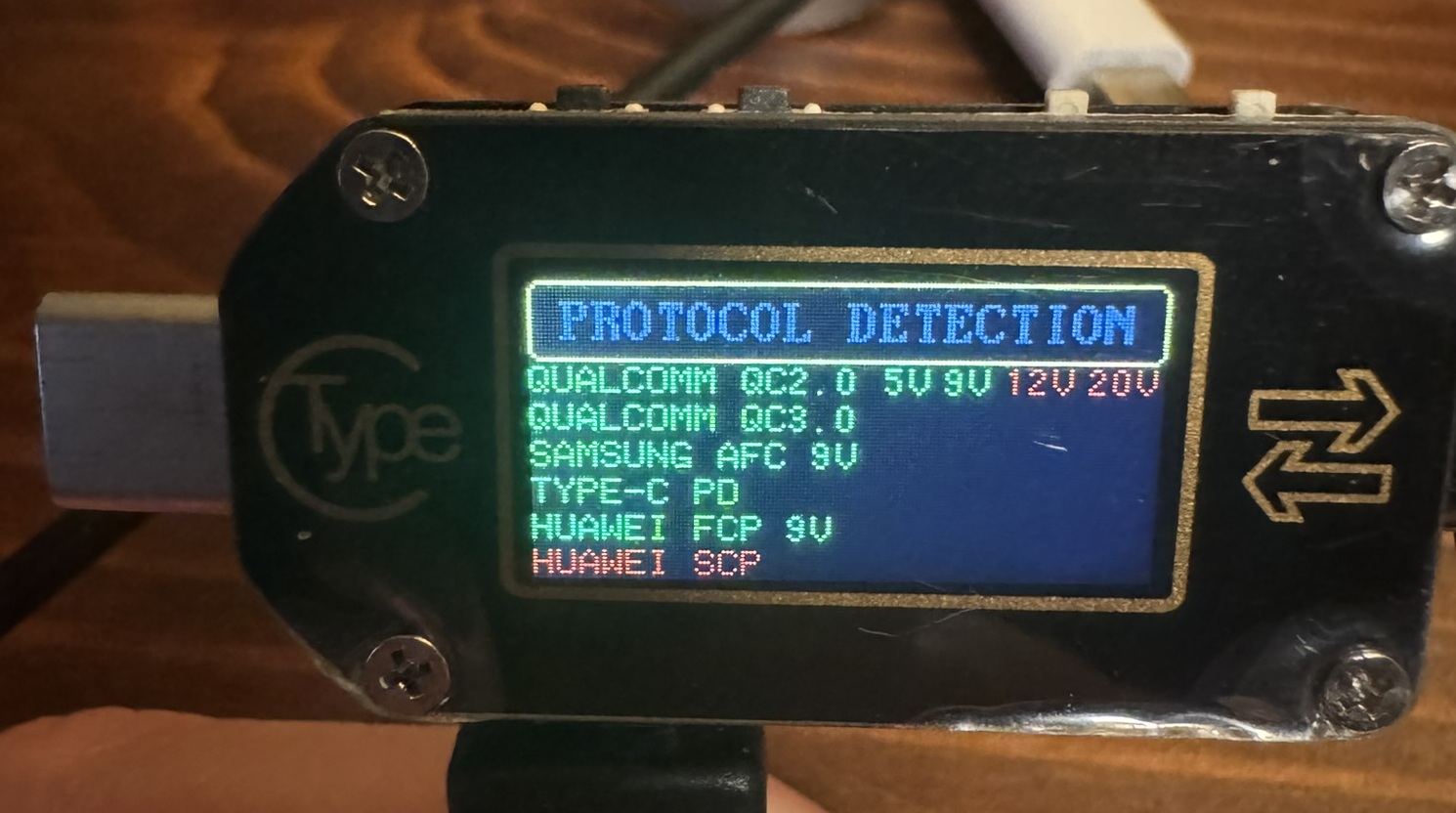

Got mine today from the OP. Seems legit from what I can tell at first glance/test, although I only have an iPhone 15 Pro to test with. My USBC tester (TC66C) shows the detected protocols. I've seen it flow 20W from the 65W port but I don't know if that's a limitation of my tester or iPhone (was at ~55% SoC).

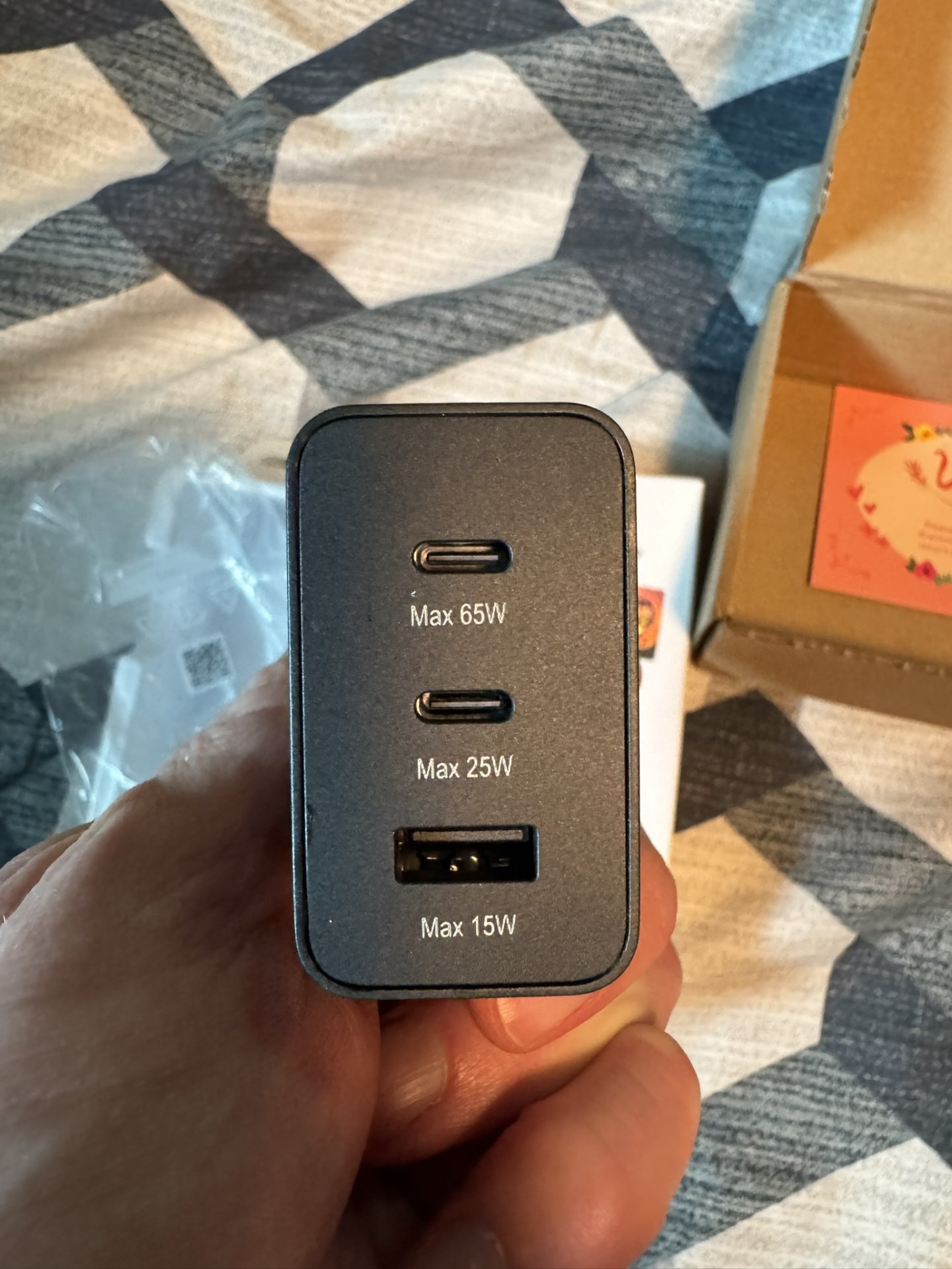

I received my "Samsung" charger today. A couple of attempts would not make my Dell Latitude recognize it. But it seems to charge my Acer Chromebook without issue, so I am happy. I'll be watching for smoke and burning odors.
My order of two units came in. It is hefty at 132 grams and it currently "fast" charging my Pixel 9a for the last 10 mins.

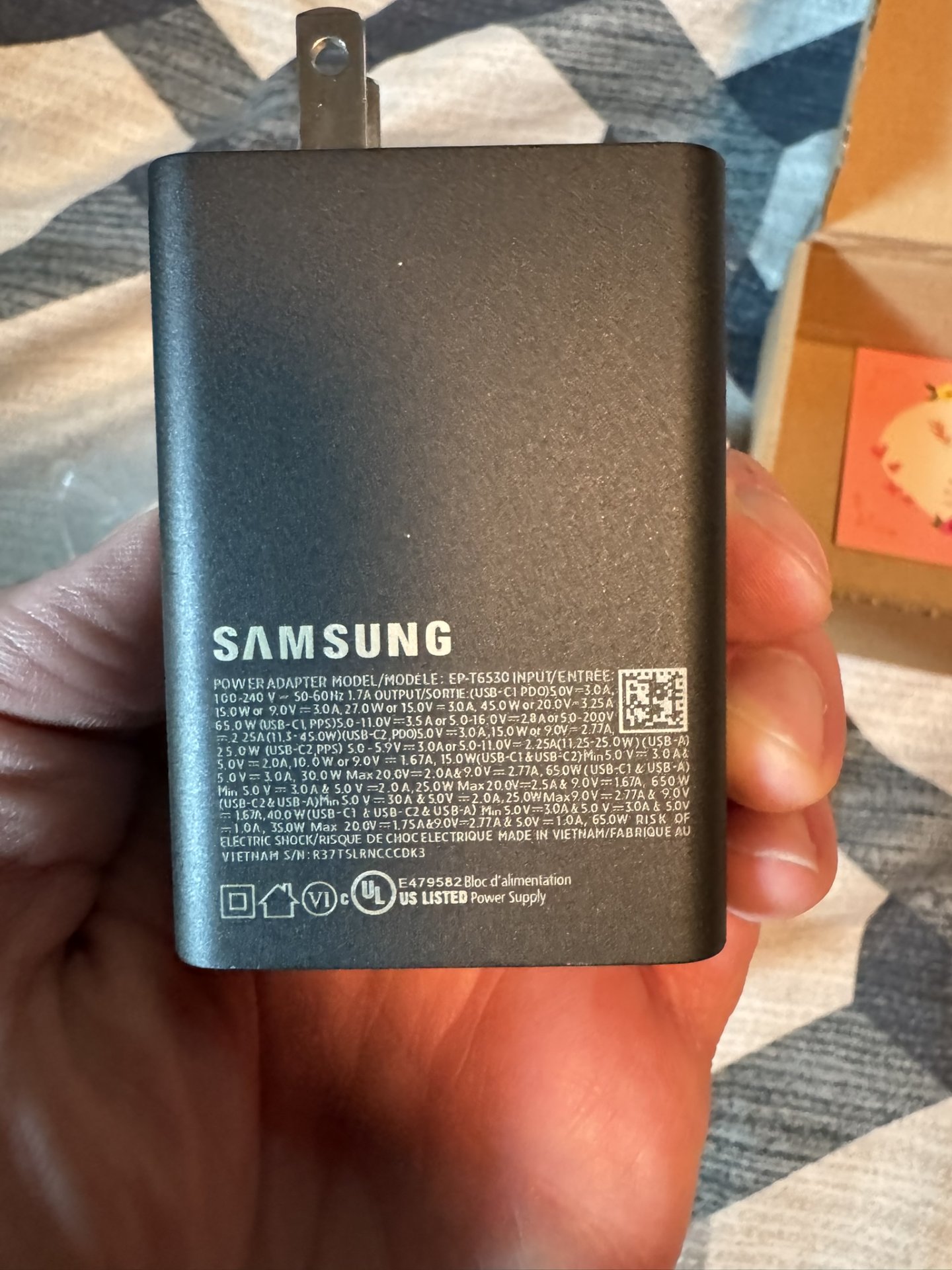

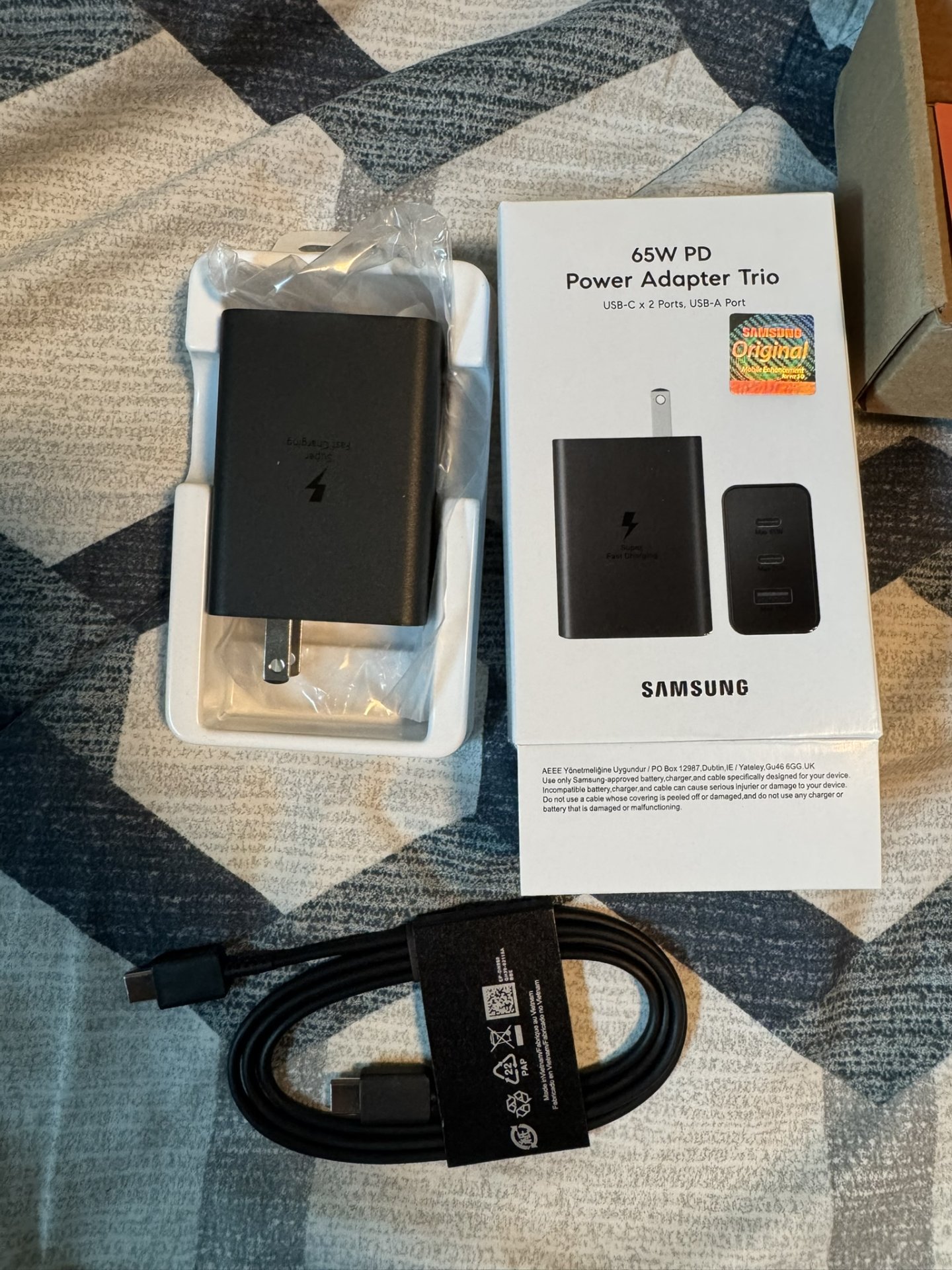

Yeah those eBay ones are fake.
The model on your box shows as "EP-T6530NBEGWW" which is sold in Africa, which of course as a different wall connector.
EP-T6530NBEGUS is the true US model.

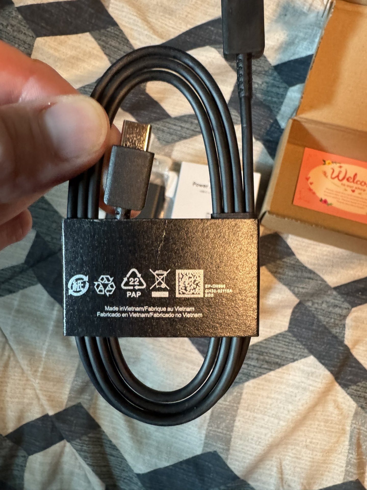

I bought 4 and have inspected 2. Both units have the same serial number on the box, which is also the same serial number as kyang's unit. The units themselves do have unique serial numbers.
If you look up the BEGWW number, it does not have a US wall connector, but these do. The part number is on a sticker applied to the white box.
