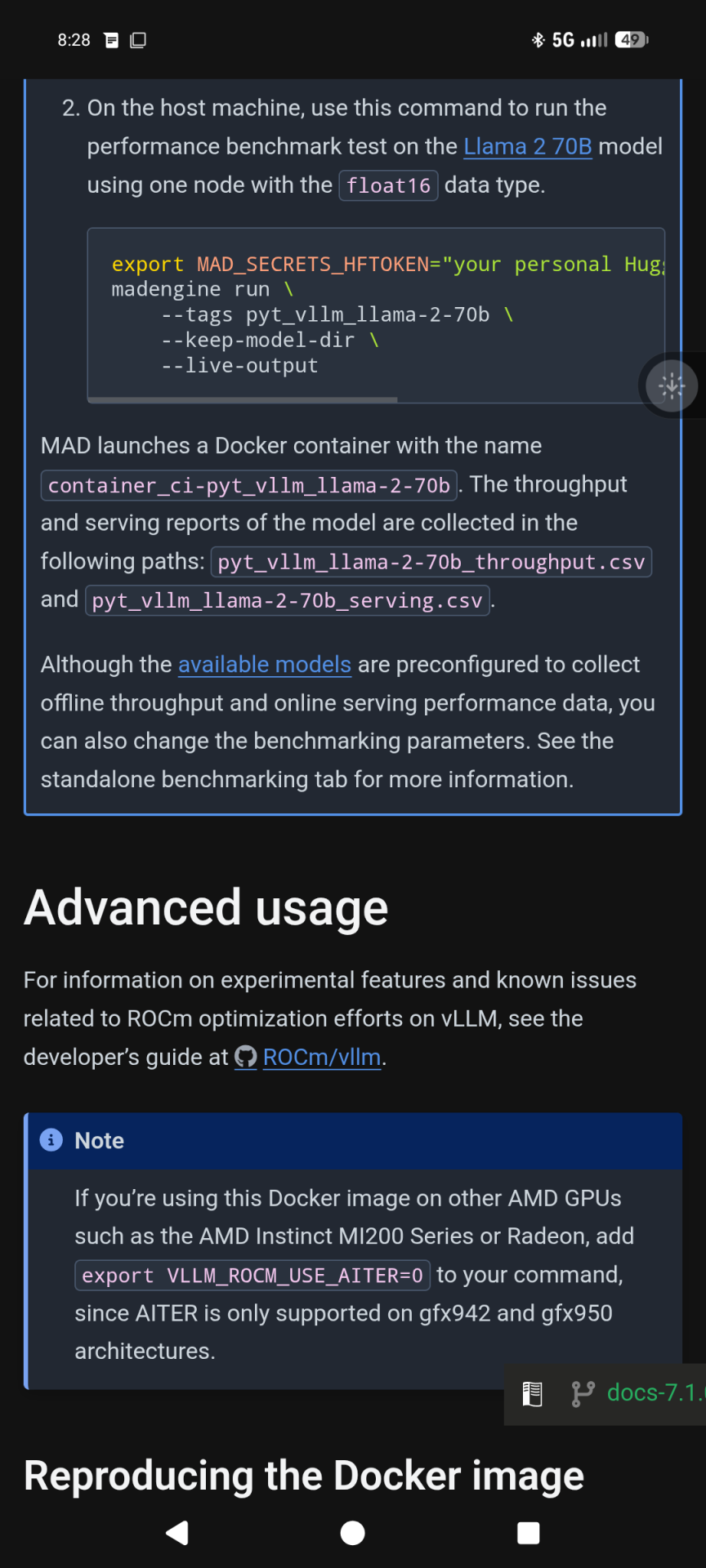

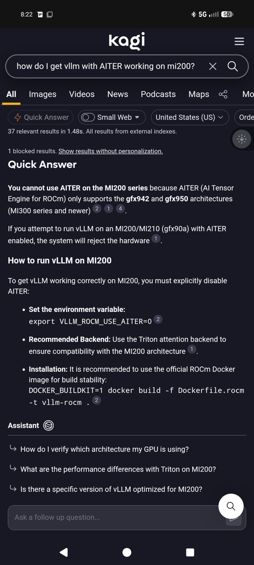

So,
I think part of this performance issue is due to the ROCm/vLLM Docker image I built. It appears to be missing the AITER kernel, which is apparently key to optimizing for performance on AMD's professional hardware.

AITER doesn't work on mi2xx or earlier generations, only mi3xxView attachment 821087View attachment 821088
"AITER (AMD Instinct Triton Extensions for ROCm) rejects gfx90a " (mi200 etc)
https://github.com/davetha/mi210-llm-stack/blob/main/guides/moe-expert-cache-vllm.md
Well that certainly explains why I haven't been able to get it working 😅
I don't know how I didn't come across this in any of my reading.
It appears that a lot of the guides and articles I have come across just assume you have newer hardware without explicitly stating it.
Thanks for the heads up. While I am a little disappointed, at least I won't be wasting any more time on this.
