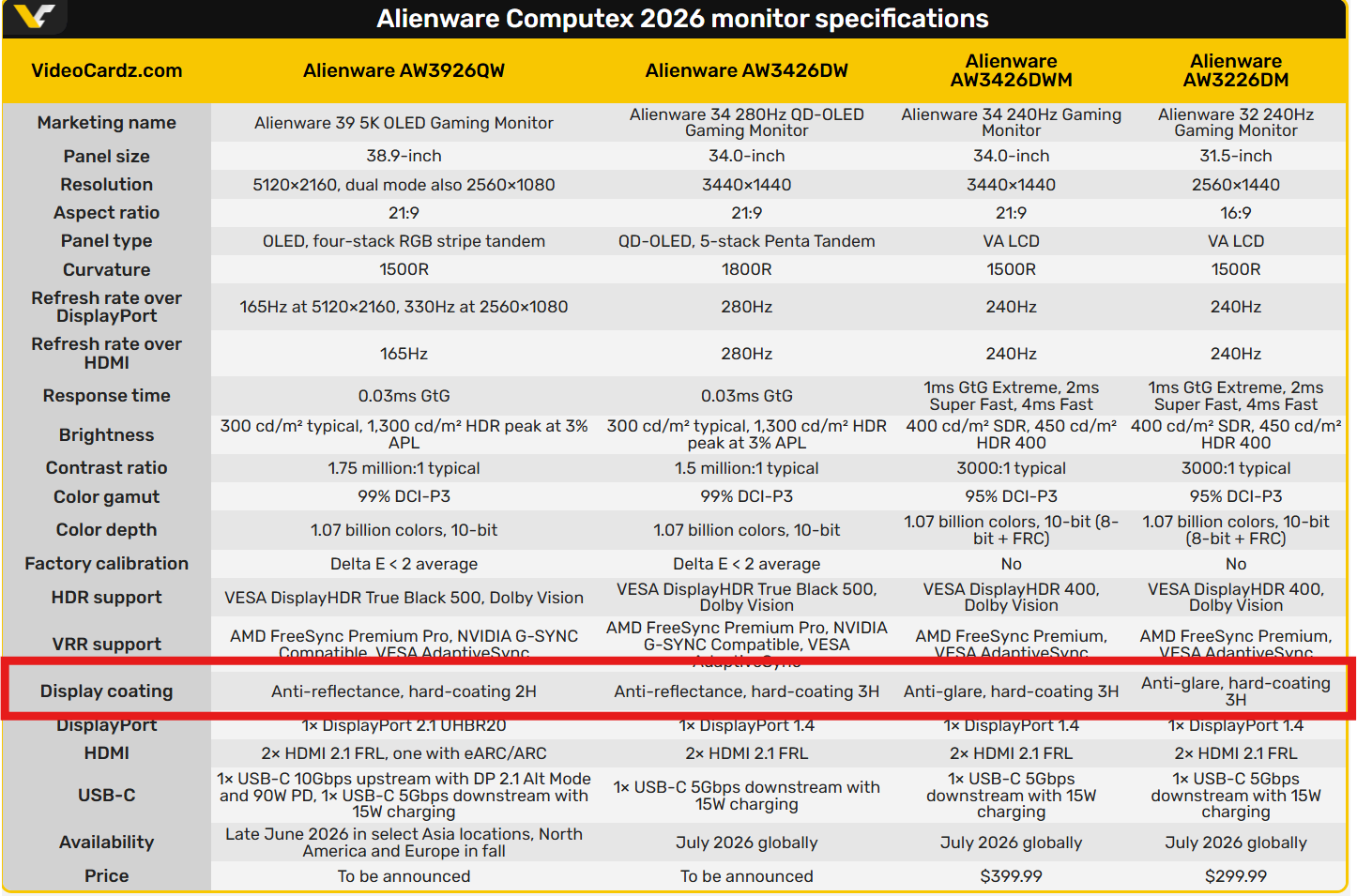

Apparently this is not the same RGWB panel found in the LG 39GX.
Alienware's own slide:
So it's glossy and no white subpixel unlike the LG model...seems like this just made the 39GX dead in the water.
I'm wondering why 2H hardness instead of 3H though, even the latest gen QD OLEDs have upgraded to 3H since there was a lot of complaints from owners of the previous gen about how easy it was to scratch up.

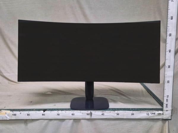

That looks different than the ‘leaked’ lab picture. That base was glossy where this one seems like a matte plastic.
Perhaps it was just lighting conditions in that photo that made it appear that way. I'll be honest though, with the announcement of DisplayHDR 1000 monitors coming from LG Display at some point this has pretty much killed any excitement I had for this monitor lol.

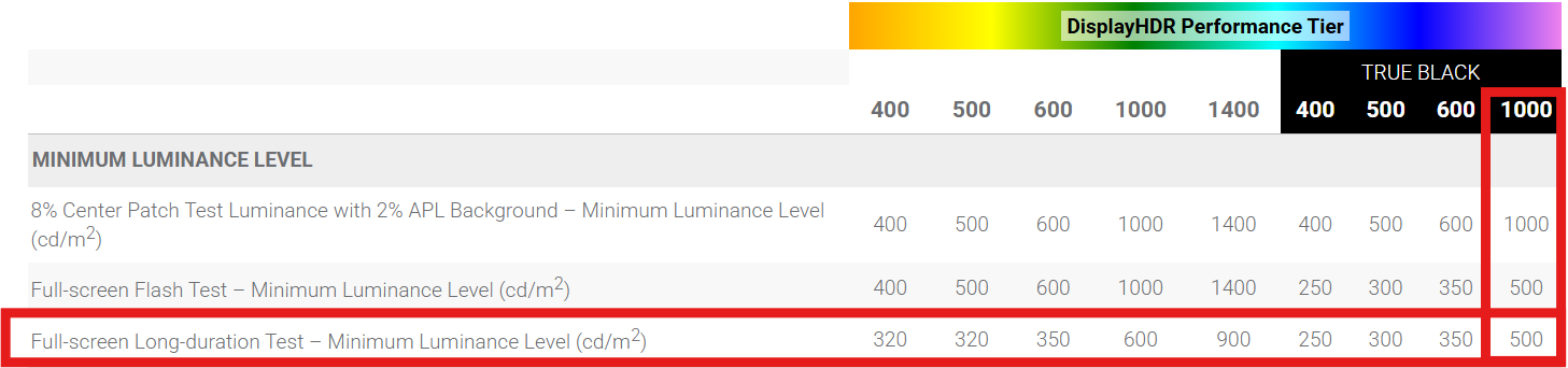

man, I thought this year was going to be the year I jumped into OLED monitors… I may still do it and then upgrade when these DisplayHDR 1000 OLED monitors finally come out (likely mid to late next year). Do we know what the sustained 100% white nit count is on 1000 True Black? I couldn’t find it with a quick google search.
500 nits.
That would give it tons of headroom to do BFI since BFI kills brightness by quite a bit, I think the most aggressive BFI settings tend to reduce max brightness by half or maybe a little bit more. It also means far, far less aggressive ABL for HDR content.
500 nits.
Wow, literally double the nits of my TB400 Alienware. That's actually worth waiting for.

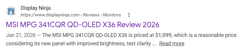

$1100? How could they sell it for that low when LG's own 39GX is $1800. If that really does end up being the price then I'll get one as well, I was expecting it to be the same price as LG. Maybe Linus got the wrong info on pricing and was given the price of the 34" QD OLED monitor instead which the price of that is......$1099.
