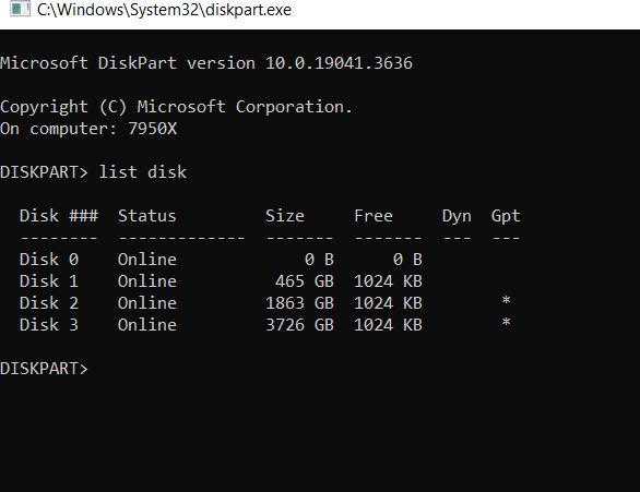

so my 5 1/2 year old drive, this one here https://www.amazon.com/dp/B085ZB51HW will not initialize in windows 10, my system went to do an update and it seemed to be taking a long time to reboot, when it did reboot the drive is gone, it gives me these errors, is this a software issue, i removed the update and even rolled back PC to a few weeks ago, i have same issue.
try a new cable and/or port. then if there is no data on it that you are worried about use diskpart to clean it and try again.

diskpart isnt going to "see" anything. its going to completely blow away the formatting/tables/whatever so it acts like a brand new drive. it may help if it is just a corruption issue.
well i tried diskpart and did a clean command, but it didn't do anything as far as i can see. but now the dead drive is not even seen as disc 0 in either diskpart or disk mangament, it's like the driver disappeared, pretty sure it's dead for sure now.
i did get the WD gold installed and copied over my latest backup to it, so all is good.
