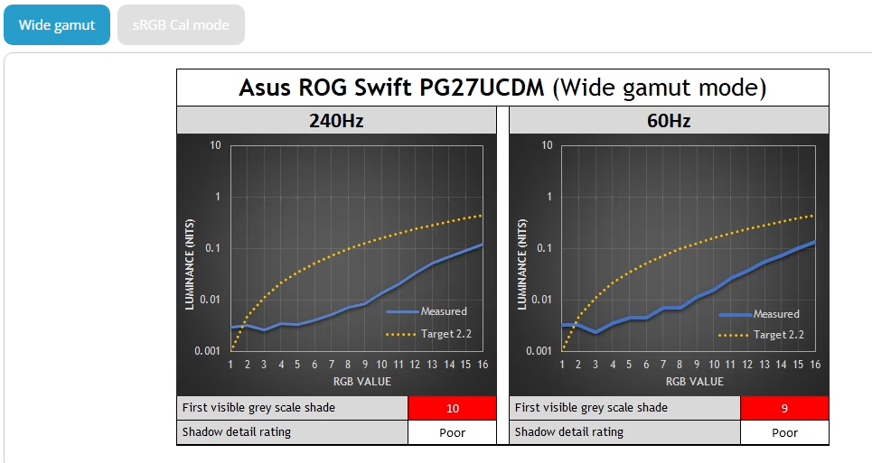

I'll post some more thoughts later I guess perhaps in my own thread, but the Asus XG27UCDMG QD-OLED has insane black crush so you completely miss out on detail that is supposed to be there, it just doesn't even show it.
https://tftcentral.co.uk/articles/d...-understanding-and-testing-oled-shadow-detail

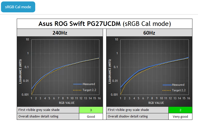

They have results for the PG version here instead of the XG one I have, mine I calibrated so it shows 6-7 instead of 10 but still, amazingly bad. If you switch to the sRGB Cal Mode though it's great...which kind of defeats the purpose of the whole monitor lol.
This combined with the pathetic brightness in HDR mode means it's basically totally useless in HDR. You lose detail at both ends, it has really bad crushing detail at high brightness levels too in all HDR modes.

3 Every SDR mode but sRGB Cal Mode crushes blacks so you lose a lot of black detail.
